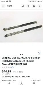

Body Do you have a recommendation for your stock hardtop strut replacement.
The Omix # 12012.08 is a stock replacement. A bit pricey at about $30 each. Advance Auto has some generic replacements, part # D4643. They're about $16 each.
All good. I went through hell trying to find a set. Everything is for the newer stuff with an all glass window not our steel frame and glass setupHey Manic. My bad. Thanks for the catch.
