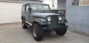

HI so I swapped my CJ7 with a Small block 302 and an Ax-15 in place of my T-5 and mated them with an Advance adapters bell housing plate and an a clocking ring for my Dana 300. I am having issues with the Hydraulic clutch linkage. I installed a 4 cylinder CJ7 master cylinder for the clutch, with a Ford slave cylinder in between. I used an 81-91 F150 Aluminum bellhousing and the slave cylinder bracket, part number: e4tz-7a544-a. I have not been able to find a slave cylinder that sits correctly on this slave bracket. In addition, When it was all hooked together, I was able to get the transmission into all 5 gears and reverse but it would slip in all the gears almost as if the clutch was not completely engaging. I used a clutch kit for a 70 Bronco with an 11 inch flywheel and threw an 11 in Chevy clutch disc to have the correct spline count for the Ax-15. Any help would be appreciated. Im pulling hair trying to get this done!
