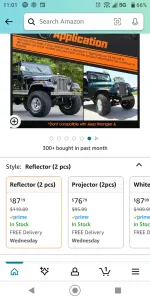

Here's a fairly cheap option from Amazon. I can't say anything about longevity or anything. But if you want the tented look it's an option b09bd221c47169b1642e54a1040a37ec.png
