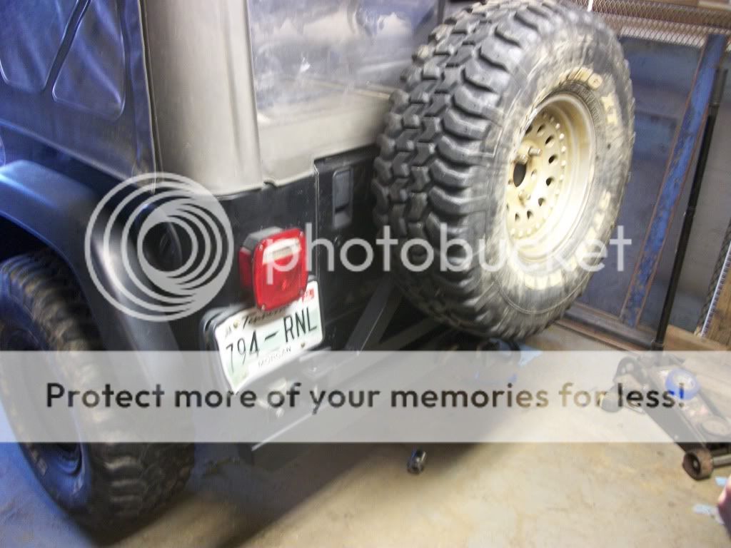

This is mine that I built.

Damnitutk I like that front bumper, did you build a rear bumper too? I kinda like my front bumper but the back one I go back and forth on, the spare tire is still mounted on the body and I'm wanting to put it on the bumper to take some stress off the body..

wadeo, this is one i helped build but as far as having one on mine right now.... it is in the process...
