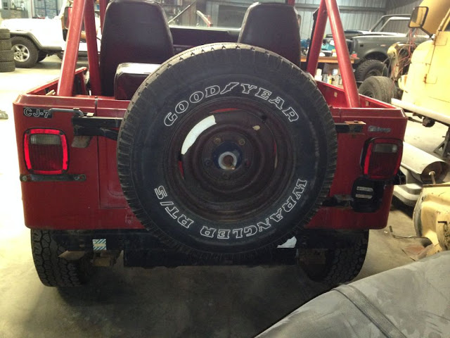

Some more before pics…
Sold the doors and top to help finance the project.
After showing Adam Brown over at Adam Brown Customs several Jeeps and having him go look at others (none of which he liked for various reasons) he steered me to a friend of his who is a bit of a Jeep hoarder. Adam told me that his friend had an 86 CJ7 in great shape.
Originally, I wanted a CJ5; going for the old Willys look. Adam told me to get a late CJ for drivability. After driving a few CJ5s I decided to go for a CJ7. Then after reading about the history of the CJ7 and the multiple variations, I decided that the holy grail was a 1986 (mid-year) with the Dana 44, longer wheel base, wide track, and 5 speed transmission. These are few and far between.
My idea of great shape was apparently different from his. I was less than enthused, but he was all agog as he climbed in and under it. This CJ7 had been owned by a woman who lived in CA for most of the thirty years this thing has been in existence and now is the only Jeep that is stored in a building… next to an old Corvette and Camaro.
Adam explained that the important thing is the lack of rust and this Jeep, in his determination, was near mint and that I'd save a lot in restoration work… not to mention it was bone stock so no one had mucked with it. I trusted him and bought it. I became the second owner of record since his friend never recorded his purchase. He had it for a couple of years in that building; saving it for a personal project that he had recently changed his mind on.
We trailered it back to Adam's shop and I began to wait my turn. So it sat like this for months.

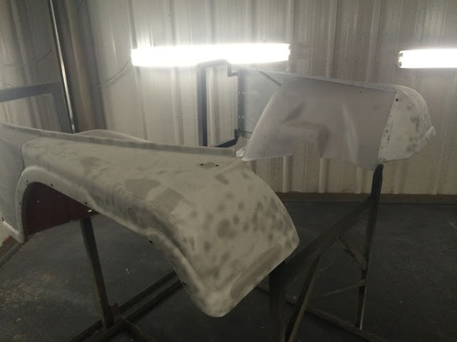

Work Begins… first of October 2016
Fenders, hood, tailgate, windshield separated for sandblasting and a little body work.
Parts all boxed and staged for blasting.
Took the seats, dash, seat belts, etc. home for cleaning and painting.
Odd that only the fenders were galvanized…
Adam finally found some rust that needed to be cut out. Under the roll bar behind the seats on both sides was pretty much gone. He cut that out and welded in new steel. That was it with regard to the sheet metal… nothing behind the hinges or anywhere else other than a little surface rust here and there.
