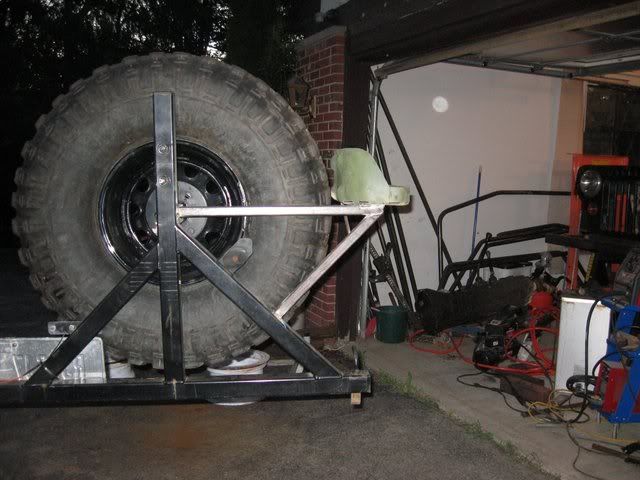

Here is my tire carrier/ can holder. it takes two 5 gal cans and mounts to the body rather than the frame, I put it on about 20 years ago and it has done no noticeable damage to the body. I am sorry I have it off , It's kind of hard to appreciate it like it is. you have a good point about carrying fuel, it is kind of difficult to find a good place to keep it and harder to secure it. It is also a PITA to transfer it to the tank from the can. I used a Oklahoma credit card but even then you have a smelly hose you have to keep some place reasonably clean.
Jerry cans are not the easiest cans to pour from and 77 CJ5's are not the easiest filler necks to put fuel in, even from a pump they can require some fineness. I have been thinking about the way boat tanks work and hoses with connectors that stay clean and you don't have to deal with too much gas smell because both ends are valved. sorry, just a little free association.
something else that I would like is a system that uses the gas in the cans first. It seems it would be good to be rid or the possible liability as soon as possible and then have the main tank full in case you crunched your cans.
Don't forget the water!!
I would suggest you check and see what is available for cans before building a rack. I have not looked full contact but what "jerry cans" I have seen recently are not quite like the ones of my youth.

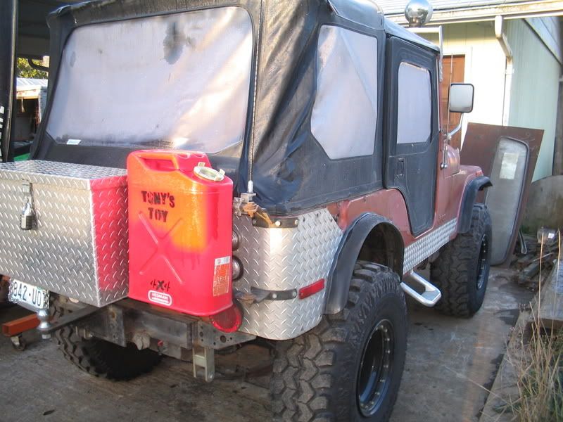

Other than that here is a pic of what my Cj had when I bought it...
It just mounts to the tool rack and swings with it. It could be modified for another tank if needed, but that getting pretty heavy for the mounts the way they are made.
